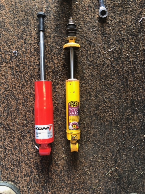

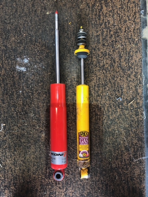

So I went ahead and installed the Koni shocks ...
Koni and Spax Rear Shock Tiger.JPG (173.52 KiB) Viewed 31620 times
Koni and Spax Front Shock Tiger.JPG (196.19 KiB) Viewed 31620 times
FDub
Posts: 8
Joined: Tue Nov 01, 2016 4:50 pm
Re: Shock Absorbers
Post by FDub » Wed Sep 26, 2018 11:52 am
They are clearly of high quality construction and are certainly considerably more beefy than the Spax units which came out. I think the piston rod measured 16mm against the Spax 12mm so 33% thicker. The bodies are significantly larger as per the photograph.
Installation was straightforward
Adjustment is done by popping on a little plastic "key" to the top of the piston rod and turning. I haven't actually done it yet, but one should be able to adjust the fronts by simply turning the wheels to full lock and reaching into the wheel well. The rear adjusters are also quite easily accessed (under the folded hood and removing the rubber grommets).
As my car is somewhat lowered and firm, and has quite limited suspension travel, I wasn’t expecting too much from this update. I was pleasantly surprised to find that there was a very definite improvement in ride quality and comfort.
I will be returning the car to something closer to OEM ride height settings before too long and I look forward, then, to the full benefits of the quality and adjustment afforded by these Koni shocks. In the meantime I am very pleased with the results I have obtained at this stage.
