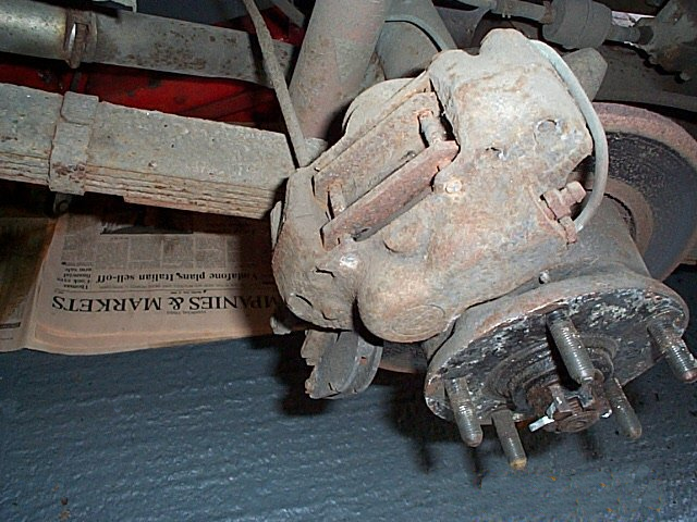

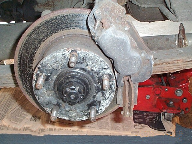

Post by gvickery » Tue Jan 18, 2011 12:32 pm
In case of interest. This is the 5 stud hub and Girling disc brake set up fitted to the rear of a prototype. The vehicle is AF202: The MKII 3 Speed Automatic that came with 14" wheels on 5 stud hubs and disc brakes on all corners

Posts: 178
Location: Nottingham
Post by Ash » Tue Jan 18, 2011 3:55 pm
Thanks for that Graham.
Strangely enought I saw that car today at Deans!
Post by gtsmrt » Wed Jan 19, 2011 6:35 am
Wow two piston setup all around 8) . That would make a huge difference in braking. What was the origin of the callipers and disc's? Was the brake system a dual system?
Thanks, Robin.
