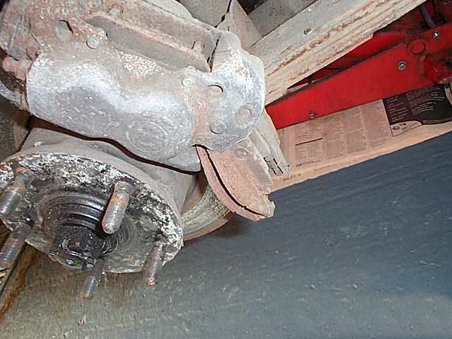

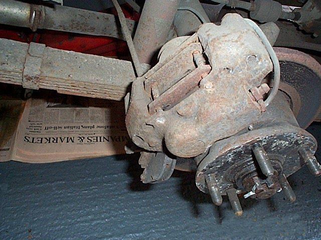

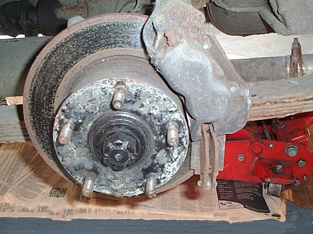

Post by gvickery » Thu Nov 08, 2012 9:39 pm
Bob
Here are some shots of the rear wheel disc brake set up that Rootes planned and Jensen developed using Girling kit that should never have been cancelled.
Bloody shame as they really stopped AF202
Post by martin172 » Thu Nov 08, 2012 10:55 pm
Are any of the parts they used generic or are they bespoke?
Post by Mal » Fri Nov 09, 2012 5:38 am
What set up did they have planed for the front with the disc rears ?.
Post by gvickery » Fri Nov 09, 2012 9:57 am
Period reports show no changes planned for up front bar 5 stud hubs.
Post by bigbob » Sun Nov 11, 2012 12:43 pm
They must have used existing calipers from another model, but which car? If they are Daimlar Dart, they appear to be very rare & expensive (shared with Aston Martin as well). Had hoped they were off a common car & easily sourced. Looks like I may have to adapt to suit Cosworth calipers, but I like to keep my car in original style when possible!
