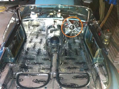

Dynamatting the passenger foot well, the rear floor, tunnel and up the firewall could at least slow heat up and even keep it down??

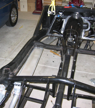

Then there is the wild step up to fit a heat shield(s) between the floor and exhaust run!

I used Dynamat on the floor and firewall of my Tiger. I then used Dynaliner over the top on the firewall. The Dynaliner is better at stopping the heat and Dynamat vibration and sound. There is no heat being transferred into the car.

I put Cool Tec foil backed material in my foot wells, which is very similar to Dynamat, it does work, I was at Le Mans Classic in 2010! I did not bother with the tunnel.
