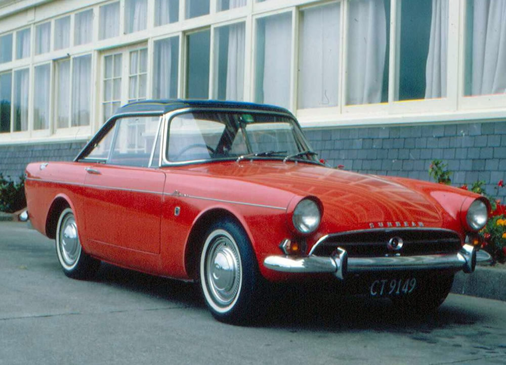

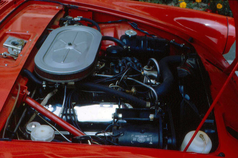

Here are three photos of a new late MK1 or an early MK1A. These colour shots are not perfect but they tell you most of the story. I can't claim to be a 'judge' (as per Norm Miller) but as Michael says almost everything installed s/b black - excepting air filter. valve covers, plastic caps, hoses and a very few aluminium parts obvious in these images. Bracketry fitted by Jensen s/b in in body colour - for header tank, steering column and the like.
Some items were finished in satin - such as the generator body, fan and oil filler cap. The 'black' wasn't high gloss but there is a shine to it.
This Tiger was shipped to New Zealand and is photographed at Todd Motors wearing, I think, NZ registration plates. I believe it must have been an RRO FE machine (right hand drive in a right hand country other than the UK) but the Alpine side flash puzzles me as I thought 'Tiger' was the brand in NZ not 'Alpine 260'.
Can any of our 'Kiwi viewers' shed any light on this and on the machine?

The Tiger photo from UK. Yes we know the car. It was imported by Todds as a demonstrator car . An Xmember drove this when he worked for Todds . The Tiger was sold by a Todd dealer in Palmerston North. It was then as shown in the photos . Another Xmember Brian purchased the car it was then painted white in the early 1980s he got the car from another xmember Alan who then purchased a Mark 11 Tiger. Another Brian painted the car British racing green and sold it to Japan in 1988. Japan drive in the left which makes our Tigers attractive to them.
I have had another look at that Tiger. It is a Tiger Mark 1 not a 1A. It has SUNBEAM above the rad. intake Mark 1A did not have this . Our Tiger is a very late Mark1,about 150 of the last Mark 1 did not have SUNBEAM above the rad. air intake . I also note that the Tiger has no service plate attached to the fire wall in front of the driver . It must have left the factory like this. You can see the tops of the rivets that should hold the service plate down .Our Tiger was like this . I have found that Jenson run out of the service plates . They did not tell the worker that drills holes that there were no service plates left so they just filled the four holes with spot rivets or screws as in the photo .

These photos are really useful to me as it helps me work out what is and isn't correct on my Mk1 car.
Way off topic I know, so apologies, but is the white bottle at the front of the engine bay on the drivers side (UK/NZ) the windscreen washer bottle? My car has it's bottle fitted behind the wooden plate in the passenger footwell, which I always thought was a strange - and inconvenient - place for it.
That is where my washer bottle is fitted. It's not nice and white like that one though. Your bottle certainly is in a strange place. That plate in my car is pressed steel, not wood as well.Way off topic I know, so apologies, but is the white bottle at the front of the engine bay on the drivers side (UK/NZ) the windscreen washer bottle? My car has it's bottle fitted behind the wooden plate in the passenger footwell, which I always thought was a strange - and inconvenient - place for it.

Tim,Tim wrote:is the white bottle at the front of the engine bay on the drivers side (UK/NZ) the windscreen washer bottle? My car has it's bottle fitted behind the wooden plate in the passenger footwell, which I always thought was a strange - and inconvenient - place for it.
On the RHD cars LHD cars the washer bottles were at the front RHS in the engine compartment, as for the "wooden board" i assume at some point your original "toe board"/false floor in the passengers compartment has been lost at some point and a home made replacement has been fittted, they are actually a pressed metal time secured by two metal tabs mounted the the floors.

While it would be a pain to fill it mounted down in there, i guess having it closer to the manual washer pump and to the nozzels would require less tubing and less vacuum effort before you got the nozzels to spray.. so perhaps it would make them system somewhat more effective... (though an electric motor does a much better job)martin172 wrote:To get it out of the airflow coming into the engine compartment I would imagine, but a strange place nevertheless.
