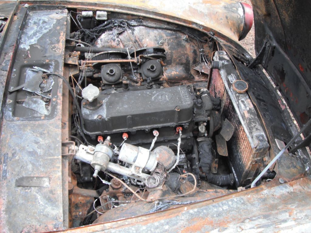

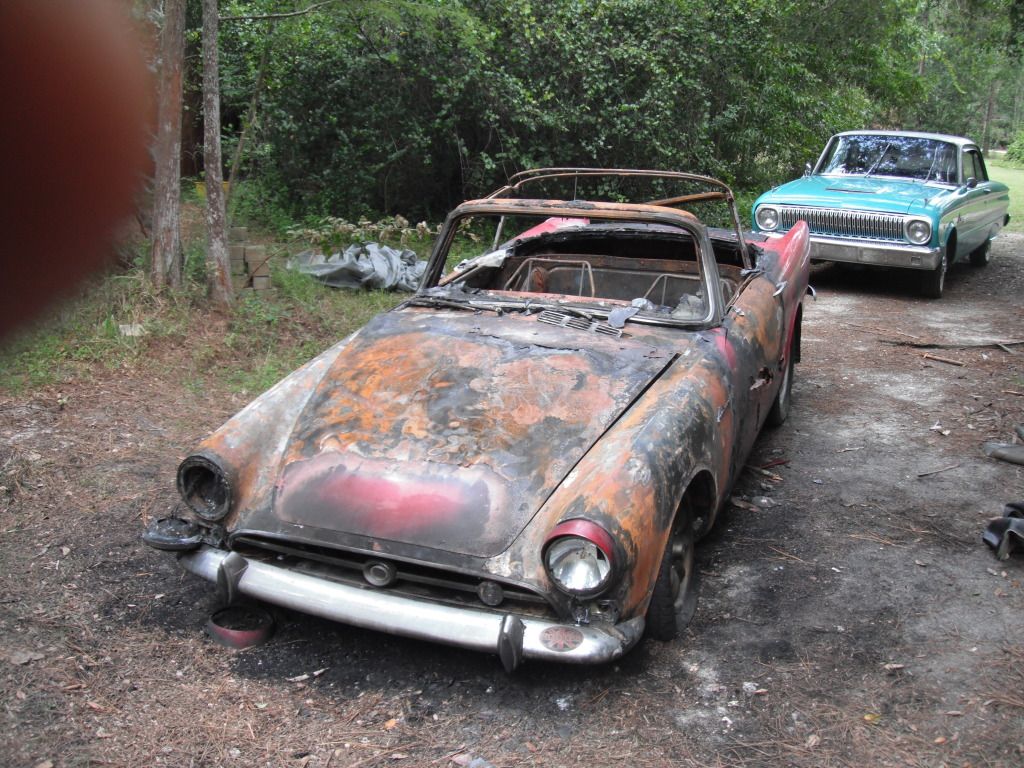

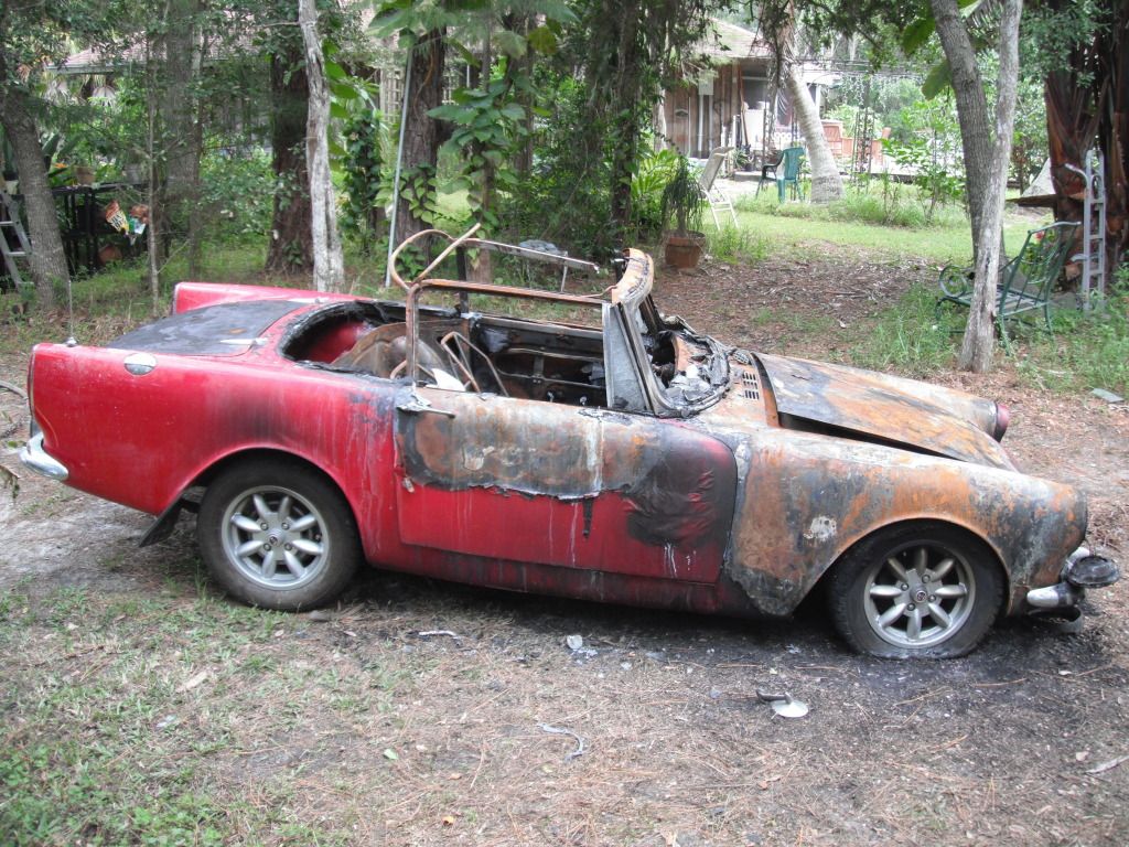

Post by Tomaselli » Mon Aug 27, 2012 10:50 am
Taken from the US forum, a poor long term Rootes enthusiast looses an Alpine - backing the car out of a gargage and it spontaneously catches fire under the bonnet :cry:
very very sad - be carefull everyone, and always carry a 'decent' size fire extinquisher!
:shock: :shock:
Posts: 392
Location: South Bucks
Post by meadowhog » Tue Aug 28, 2012 10:08 pm
I had a close call with an Alpine once. The dash lighting wiring shorted. Lots of smoke but pulled the battery connection off before a fire started.
Bit more tricky in a Tiger but worth sticking in a connection breaker in, check or replace loom and I would also suggest using copper fuel lines if yours has got the plastic one. Once the plastic one gets a hint of fire it spills petrol on the floor and woooosh. Believe me thats not nice, Ive seen it happen to a MK2 Escort. Once the tyres are alight you'll need more than a fire extinghuisher
