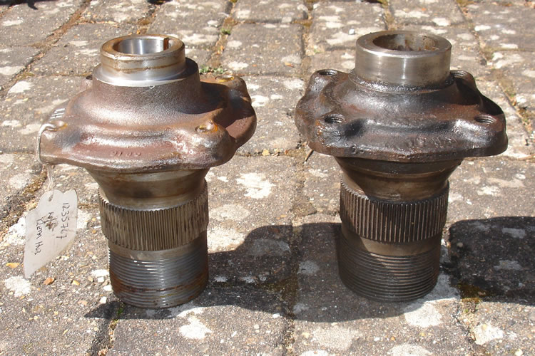

Well I can't say I did it... but on Friday I helped Malcolm Sedman and Andy Carter replace the splined hubs on ADU 638B with the regular Tiger items (pending sourcing re-produced splines as the taper on the Tiger looks to be a unique Dunlop item) and replace the exhaust system with another set of the mild steel version. Also ahead of the Schloss Dyck Classic Days excursion!
Just need a rolling road power run / test on Friday at Austec in Crawley
Alpine rear: Left - Tiger rear: Right
